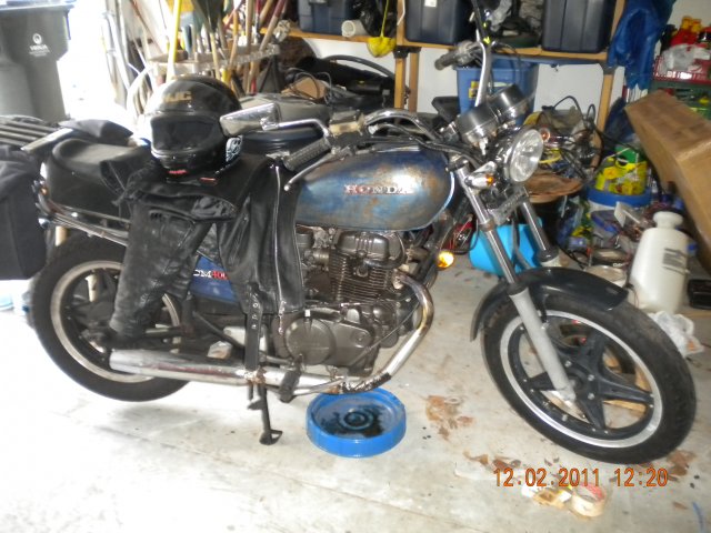

    It looks ruff but it is a solid bike the last owner tryed to strip off paint and... ya it did not go well.  So as you can see most of the black is off the bike am working on getting blue off it to get it down to plastic / metal to get a nice base coat on it then take it up to the local Tech college and have them paint it (because they are going to school for it and it will be cheap and easyer for them with proper the equipment).  Going to also do the body work myself (got to learn some where).  But the leak from where the Oil filter goes still leaks when the bike is on but not when it is off, But I found out there is a rubber seal that I need to replace (wish I knew that before I filled it with oil and new filter.)  But I'm learning.

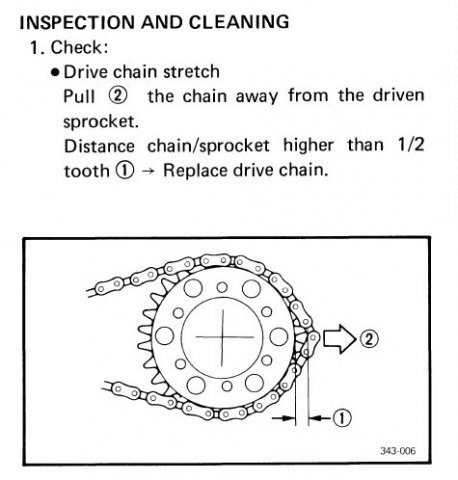

    With the rear tire and chain with the chain being lose.  Should I replace it or just move the rear tire and wheel back and titen the chain up because it has 2-3" of play on the bottom and 1-2" on the top so I know it is lose.  But I need to know what to look for to see if the chain stretched or just was lose from being used.

     I've attached a section from a Yamaha XV250 service manual that shows how to inspect the chain for wear.
    Also, inspect your drive sprockets, the ends of the teeth should be square, not pointed.
    Both the front and rear sprockets should be replaced when the chain is replaced.  I buy chains and sprockets for our Hondas from  Bike Bandit dot COM

    Man that bike don't look near as ruff as I was expecting from your previous posts and when you said you got it for $300.
    Hell your practically on the road already.
    Do those mufflers have any baffles in them?
    December 6, 2011 8:24 AM PST

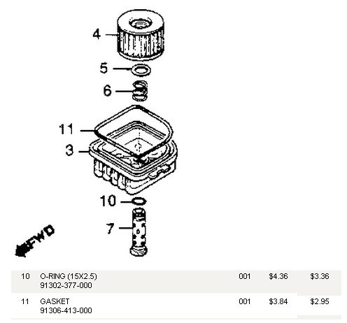

    yep it runs good but it has a hell of an oil leak where the oil filter goes going to try some liquid sealent to seal it it keeps driving me nuts. Been on the road doing some pratice oil leak or not just need to buy another quart of oil but I got to ride it 2 times. The old owner got a bagger and needs the cash so he is letting it go cheap. (he needed the $300 for his clutch upgrade to hydrollic). Nope they are strait pipes off a sporty from what I was told.

     You can probably get O-ring  #10 at the auto parts for a buck.

    If its been sittin a while then your beast bet is to replace any and all gaskets and seals that are easy to get to. Gaskets should only be a couple of bucks and like Mike said a good hardware store should have all the o rings you need.

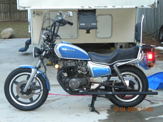

    Those aren't straight pipes. They are mufflers (probably with the baffles removed) and they aren't off a sporty. They wouldn't fit if they were.
    I don't recommend you use a liquid sealer. They can do more harm then good, but if you do, use it very sparingly. If it gets into the engine it can cause major problems. If you've changed the filter and it still leaks, it could be an issue with the thread. Clean the thread out really well. Make sure there is no debris. Then inspect the thread for wear/damage.

    I'm going to run to the dealer here, because we don't have any salvage yards that have bikes. Yes, I would like to modify it not just put it back to stock. As for tuning the carb for the unbaffled muflers any ideas? I don't have a clue as of yet this is my first and learning bike for repairs and working on. As for what they got the mufflers off of, I was told that was what they were off. But I dont know for sure. But they are welded on.
    I took the Oil Filter off again after draining the new oil and cleaned it all again. It was still going over the #11 gasket and I cleaned the grove that the #11 Gasket sits in so maby it will help. Looked at the bolt and looked for worn or cross threading and they look good no worn or metal flakes hanging off the threads or in the old oil. And thanks for the heads up on the liquid sealer.

    Ok.... Got the Oil leak stopped! Finally took it off and cleaned every thing again put it back on and it did not leak filled the fluids again and started it up and ran it around the block and still no leak it looks good!
