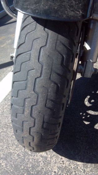

    I just replaced this front tire.  This tire was on the bike when I got her, 36K miles ago.

    I bought this bike in May, 2010. As I said earlier, I just replace the front tire with 36K on it. The first rear lasted me 11K or 12K and the second rear about 14K. AM on the third rear with 11K on it and it still has a LOT of wear left, but it is also one of the new triple compound tires. I am now running Michelin Commander II's front and rear.
